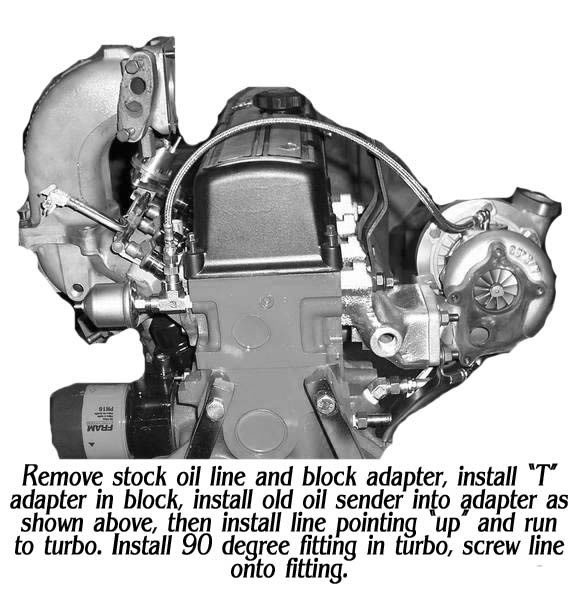

thanks stinger thats helped alot. do you think it would hurt the turbo if we add a 90 off the t block. we wanted to be able to wrap the oil feed line around the head.
Post by Stinger on Jan 5, 2009 22:23:08 GMT -5
It won't hurt the turbo...you could just turn the T block to point backwards...it might not be long enough to go all the way around though. You see the small plug in the back of the head? That is the same oil galley, it can be used as an oil feed port as well.

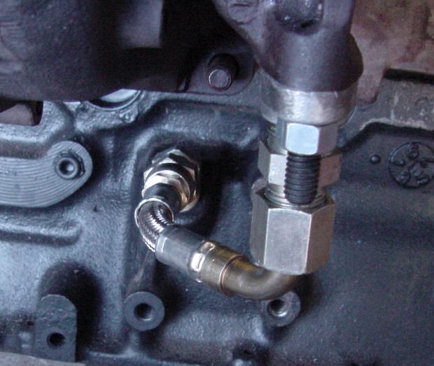

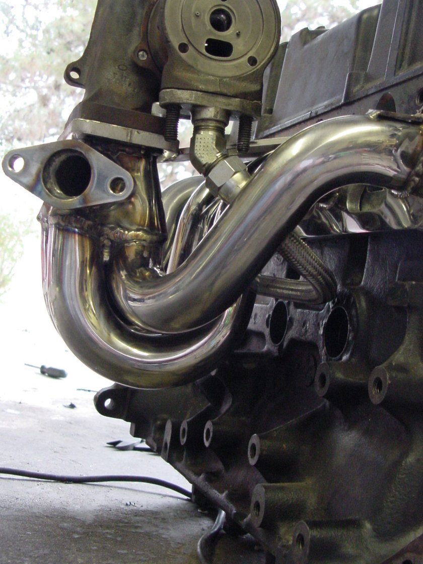

Post by shizznizz980 on Mar 12, 2013 0:47:14 GMT -5
Can I get pictures of how you have the header version bolted on at the block side please? I'm having problems getting it to route right and drain properly, I have Bob barkers old setup with the Precision 6031 and he had it with the 45 degree fitting at return flange to the 90 degree that comes on the line mated to another 45 degree at block. Can't I just flip the line around and do 90 degree with a straight fitting from turbo to 45 degree fitting at block and have a decent angle for it to drain right? Sorry for all the questions I'm still learning my turbos
Thanks
Post by Stinger on Mar 12, 2013 0:55:34 GMT -5
At the block side, the 45 degree fitting is pointing straight up and the 90 degree elbow on the line is threaded onto it.
Post by shizznizz980 on Mar 12, 2013 2:10:29 GMT -5
Ok I'm going to give that a try thanks Stinger.
